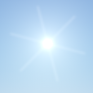

Glare Effects#
Threshold The brightness threshold, which is used to detect if an object should be blurred in the HDR mode. By the minimum value of 0, the bright areas can become overexposed.
Console access: render_camera_effects_threshold (API control)
Threshold = 0.6
Threshold = 1.2
Dirt Scale The intensity of lens dirt effect modulating the pattern of lens flares defined by the Dirt Texture. For example, it can be used to create an effect of unclean optics when the camera looks at the sun.
Console access: render_dirt_scale (API control)

Shafts The number of shafts in a cross flare. High number of flares can cause a FPS drop on low-performance hardware. To use this option, rendering of cross flares (see the Cross) should be enabled.
Range of values: [2, 32]. The default value is : 4.
Console access: render_cross_shafts (API control)
Shafts = 2 (minimum)
Shafts = 6 (by default)
Shafts = 32 (maximum)
