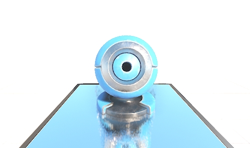

Metalness#
Metalness multiplier. By using this parameter, you can affect metalness of the scene: make all materials to be metals (Metalness = 1) or dielectrics (Metalness = 0). Using this parameter in pair with Metalness Visibility allows you to get the result as if the metalness stored in the shading buffer has been actually changed.
For example, if Metalness Visibility = 1, the result will be the following:
Metalness Visibility#
Visibility factor for the metalness multiplier that specifies how much this multiplier affects the final image.
