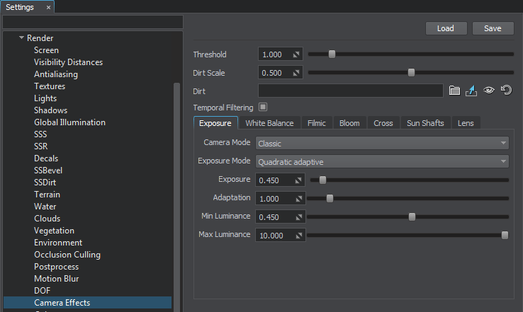

Camera Effects
A camera effects list contains features specific to the usual SLR camera. To tweak, use Rendering panel -> Camera Effects.

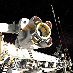

Camera Effects Applied to Viewport
Camera Effects
Common#

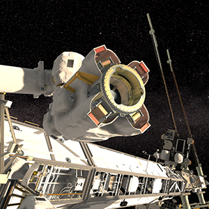

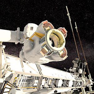

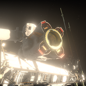

Threshold Brightness threshold used to determine areas to be illuminated:
  • By the minimum value of 0, the bright areas can become overexposed.
  • The higher the value, the fewer objects are bright enough to be illuminated.
Threshold = 0.6
Threshold = 1.2

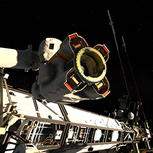

Dirt Scale Intensity of the dirt texture.

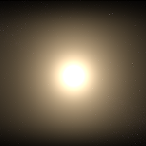

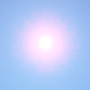

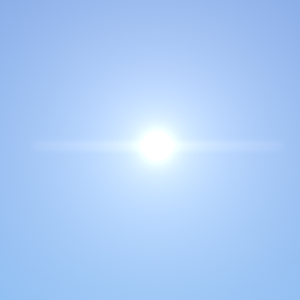

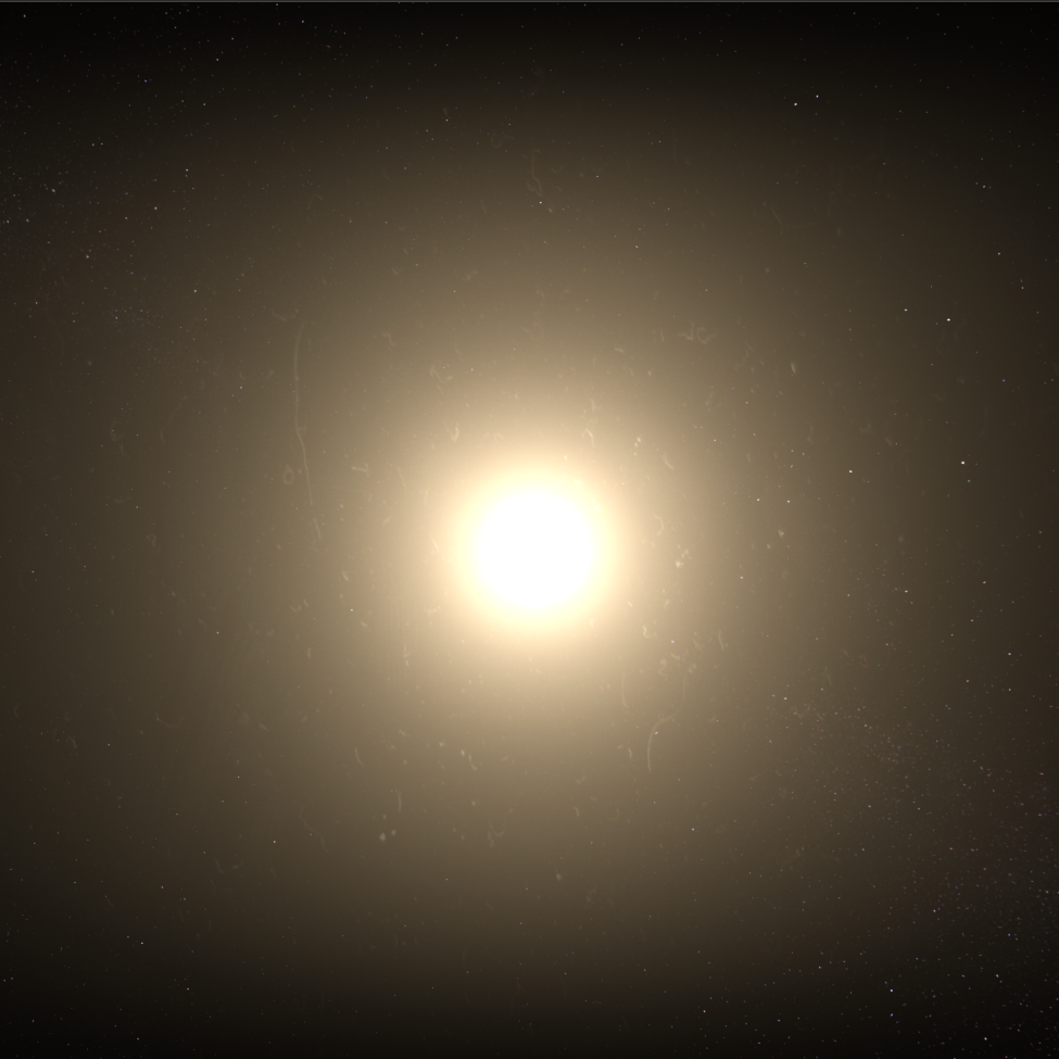

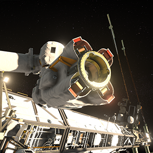

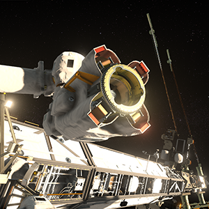

Dirt A texture that creates an effect of dirty camera lens. For example, it can be used to create an effect of light reflections or unclean optics when the camera looks at the sun.
Example of dirt texture
No dirt texture
Custom dirt texture
If you can't see the dirt texture, try tweaking the threshold parameter.

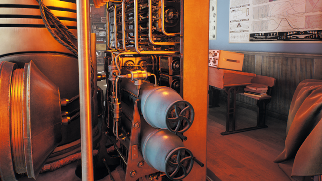

Temporal Filtering Reduces flickering of the bloom effect on the small bright objects (such flickering may appear when the camera moves). For example, it can be used in scenes with industrial pipes.
Exposure#

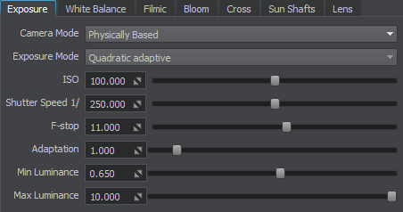

Exposure settings in a physically-based camera mode
Camera Mode Camera mode, determines the way the exposure is set:
  • Classic — classic camera model. The amount of luminance is determined by the Exposure parameter, when Exposure Mode is set to Static.
  • Physically Based — physically based camera model. The amount of luminance is determined by the following set of parameters: ISO, Shutter Speed, F-Stop.
    Exposure Mode for a physically based camera should always be set to Static.
Can be controlled via the render_camera_mode console command.
Exposure Mode Exposure mode:
  • Static — a static exposure. The amount of luminance is determined depending on the Camera Mode parameter.
  • Logarithmic adaptive — adaptive logarithmic mapping technique.
  • Quadratic adaptive — adaptive quadratic mapping technique.
Can be controlled via the render_exposure_mode console command.
Exposure Camera exposure. It determines the resulting amount of luminance:
  • By the minimum value of 0, the image is rendered black.
  • The higher the value, the more the luminance is and the brighter the scene is lit.
This parameter is available only when the Camera Mode is set to Classic.
Exposure = 0.2
Exposure = 1
Can be controlled via the render_exposure console command.
ISO ISO number represents the sensitivity of the camera sensor. The higher the ISO number, the more light is collected and the brighter the image is.
  • This parameter is available only when the Camera Mode is set to Physically Based.
  • Can be controlled via the render_iso console command.
Shutter Speed Shutter speed indicates how long the sensor of the camera is actively collecting light. Higher values make the shutter speed faster and the image — darker.
F-Stop Ratio of the focal length (f) and the diameter of the lens opening (D): f / D. It is the reciprocal of the relative aperture. The higher the value, the darker the image is.
  • Can be controlled via the render_f_stop console command.
Adaptation Time in seconds for the camera to adjust exposure (0 for instant adaptation).
Min Luminance The minimum luminance offset relative to the default luminance of the scene used for rendering of the adaptive exposure effect. The higher the value, the darker the adapted image is.
The parameter can take on negative values.
Min Luminance = -1
Min Luminance = 2
Max Luminance The maximum luminance offset relative to the default luminance of the scene used for rendering of adaptive exposure effect. The lower the value, the brighter the adapted image is.
If the specified value is less than the current minimum luminance, the minimum luminance value is changed to the specified maximum luminance so that they are equal.

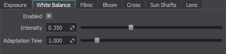

White Balance#
White balance correction eliminates the discoloration in the final image due to certain colors in the scene having more intensity and/or a higher or lower color temperature. Adaptive automatic white balance correction ensures realistic coloration of your scenes in real-time mode.
To ensure the most natural look of your scene, adjust colors of light sources by setting color temperatures. In case of heavy high-contrast discoloration (e.g., too warm and too cold lights in a dark room), the final image may look unnatural.
White balance settings
Enabled Toggles automatic white balance correction on and off.
Intensity Intensity of white balance correction.
Adaptation Time Time period in seconds, during which white balance correction is performed (0 for instant correction).
It is recommended to use lower values, when possible, to make correction process unnoticeable, otherwise it'll be slow and noticeable. However, setting too low values may result in abrupt switching of colors as the camera moves. So, adjust this parameter carefully to make transition smooth. You can set it equal to the Exposure Adaptation value.

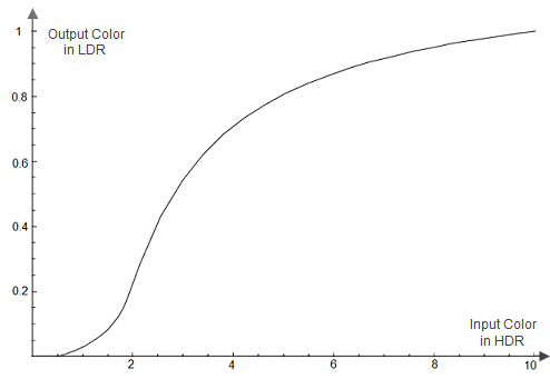

The filmic tone mapping provides better image quality. It lightens the darkest image regions and makes the lightest regions darker.
All parameters described below represent the tone mapping curve, which is constructed by using the following formula:
  • A — Shoulder Scale
  • B — Linear Scale
  • C — Linear Angle
  • D — Toe Scale
  • E — Toe Numerator
  • F — Toe Denominator
Tone Mapping Curve
For more details about tone mapping curve construction see the article on An efficient and user-friendly tone mapping operator.

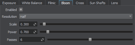

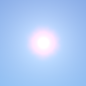

Bloom#
Bloom settings

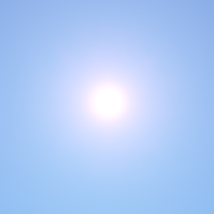

Enabled Toggles the bloom effect rendering on and off.
Resolution Resolution of the bloom effect:
  • Quarter — quarter resolution
  • Half — half resolution (by default)
  • Full — full resolution
Scale Scale of the bloom effect.
Power Power of the bloom effect.
  • At the minimum value of 0.0, the bloom effect is blurred.
  • At the maximum value of 1.0, the bloom effect is more contrast.
Passes Number of passes for the bloom effect. During each pass, a bloom texture is generated. Up to 8 bloom textures can be generated: every next texture has a lower resolution (original size, original size /2, original size /4, so forth) with bloom effect. After that, all these bloom textures with different resolutions form the final bloom texture.

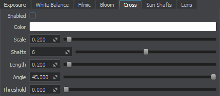

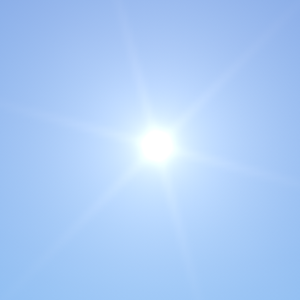

Cross#
Cross Settings

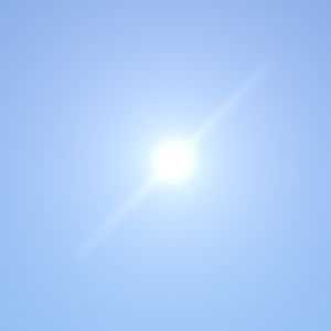

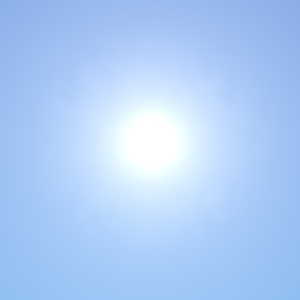

Enabled Toggles cross flares rendering on and off.
Color The color of cross flares.
Scale Scale of cross flares. Higher values produce more pronounced flares.
Scale = 0.4 (by default)
Scale = 0.7

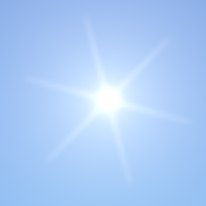

Shafts The number of shafts in a cross flare.
  • The maximum number of shafts is 32 (high number of flares can cause a FPS drop on low-performance hardware).
Shafts = 2 (minimum)
Shafts = 6 (by default)
Shafts = 32 (maximum)
Length The length of cross flare shafts. Increasing this value also leads to fading of shafts.
Length = 0.2 (by default)
Length = 0.4

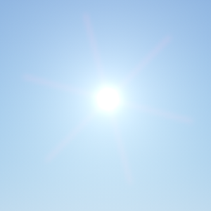

Angle Cross flares orientation angle. The default is 45 degrees.
Angle = 45 (by default)
Angle = 90
Threshold Brightness threshold for areas to produce flare. The higher the threshold value, the brighter the area is to produce flare.

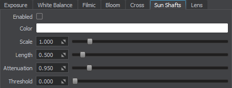

Sun Shafts#
Sun shafts settings
Enabled Toggles sun shafts rendering on and off.
Color The color of light shaft.
Scale Scale of sun shafts. Higher values produce larger shafts.
Scale = 1 (by default)
Scale = 2
Length Length of sun shafts.
Length = 0.8
Length = 0.95
Attenuation Extent of the shafts fading out along their length:
  • By the value of 1, there is no additional attenuation.
  • The lower the value, the smaller the shaft is.
Threshold Brightness threshold for sun to generate light shaft:
  • The higher the threshold value, the brighter the sun should be to generate light shaft.

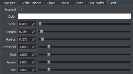

Lens#
Lens settings

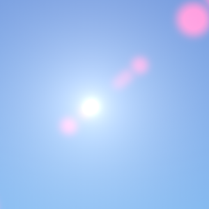

Enabled Toggles lens flares rendering on and off.
Color Color of lens flares.
Scale Multiplier for a color of lens flares.
Scale = 0.25
Scale = 0.5
Length Length indicating if the whole radial lens flare is rendered on the screen or only a part of it. This option controls how lens flares pattern is distributed.
Radius Radius of the spherical lens flares on the screen.
Radius = 0.07
Radius = 0.1
Threshold The brightness threshold for areas to produce flare. The higher the threshold value, the brighter the area should be to produce flare.
